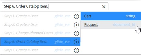

So, in my first test I did I used the Service Portal to submit the request. I was able to get the sys_id of the request from Open a Catalog Item (SP) but from what you said the equivalent test step in the standard UI does not give the sys_id of the request. Screenshot below when you configure the record query it shows like the Oder Catalog item is going to give you the request document id. Seems like there might be a logic issue there if that is the case.
