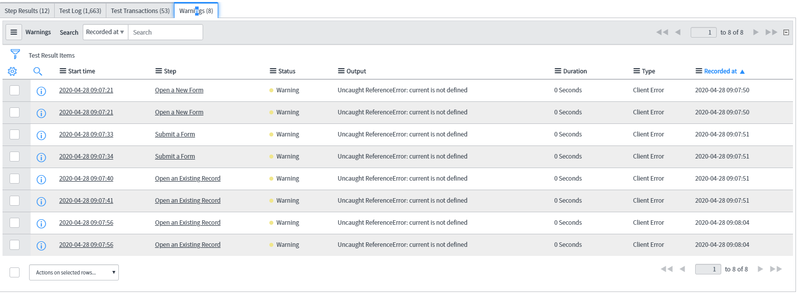

I made some corrections.  Would you tell me if I have too many steps to accomplish this?  Also, do I need to be concerned about the warnings?

Warnings

Hi Laurie,
Yes steps can be shortened here:
like step no 4, 5 and 6 into one step called 'Record Insert' and similarly for step no 8 to 12 can be shortened as 'Set Field values' and 'Field Value validation'. Hope that much should serve the purpose.
Warnings we can ignore unless until there is an error we are good with the test steps.
