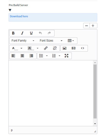

I need to attach the file within one variable as a link to download it.
But when I tried that as HTML Type it is not working perfect as the Description field is also coming on the form.
Catalog Item View:
And I forgot to mention that the Script does work for me and my concern is will it also work for Service Portal as well?
So please kindly suggest me how can I achieve the same?

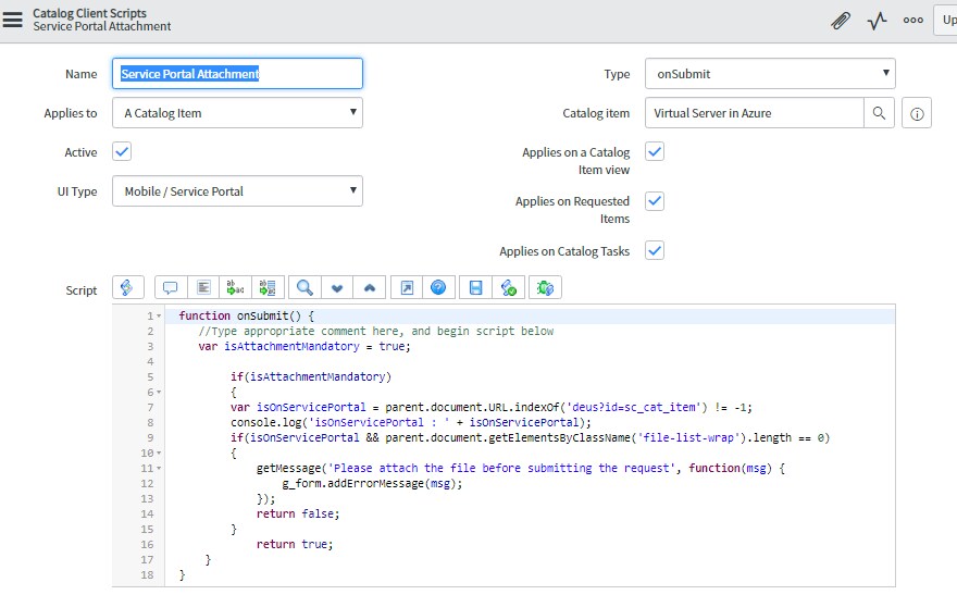

For service portal you might need to add another script:
function onSubmit() {
		var isAttachmentMandatory = true;
		if(isAttachmentMandatory)
		var isOnServicePortal = parent.document.URL.indexOf('deus?id=sc_cat_item') != -1;
		console.log('isOnServicePortal : ' + isOnServicePortal);
		if(isOnServicePortal && parent.document.getElementsByClassName('file-list-wrap').length == 0)
			getMessage('Alert Message', function(msg) {
				g_form.addErrorMessage(msg);
			return false;
			return true;

And for Service Portal do I need to add the script which you have mentioned in previous post?
So there will be two OnSubmit Client Scripts.
SNOW@Das
You can add both if you want. One will work in native platform second on Portal.

I tried the script for Service Portal but it seems it is not working incase of Service Portal.
Can  you please check and let me know?
