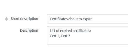

Again getting a report attached to a task is tricky so hopefully this solution will satisfy your requirements.  Idea is that your list of expired certs will show up as Affected CI's on this custom task.  From there you can drill into them to see details on the certificate and its "Affected by Task" list.  In my testing of this solution, I created an incident, but it doesn't matter which type of task you are creating.
The description field gets set by a list of certificate names:
The Affected CI list is populated with this same list of certificates:
