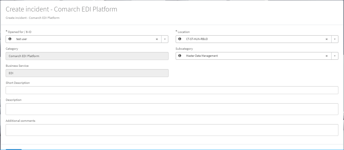

Hi Snow Enthusiasts,
The Case: Created a record producer on Incident. Need to map variable values to incident fields. The record producer is in the service portal. Variables present are: Requested for, Location, Business Service, Category, Subcategory, Short Description, Description, Additional comments. All variable names have been given same as the corresponding incident field names where they need to map.
The Issue: The variables Requested for, Location, Business Service, Category, Subcategory are mapping fine in the incident fields. But variables Short Description (wide single line), Description (multi line), Additional comments (multi line) are not mapping whatsoever.
My Tries: I tried with the scripting area in the record producer. Tried by taking the values of the faulty variables in a variable in the script and changed to toString() but no luck. The variables Short Description, Description, Additional comments were in a variable set earlier, I removed the variable set and made direct variables on the record producer and then used 'Map to field' check box but still no luck. The variables Requested for, Location, Business Service, Category, Subcategory are also in a variable set but they work fine.
The Note: The issue is only from the portal side. In the native view, the mapping for the same RP works fine.
The Request: Please let me know if I am missing a simple trick here or what else can we do to achieve the mapping.
Before submission:
