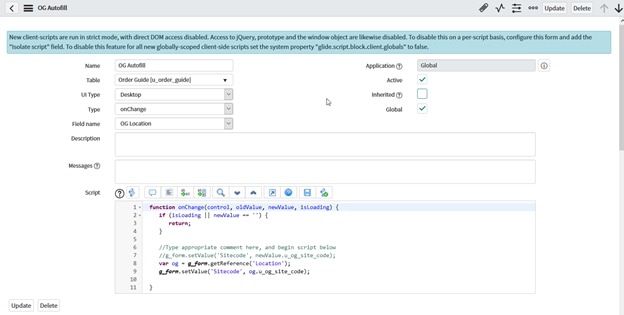

On my test catalog item, I have created two variables, one call 'Location' and the other called 'Sitecode'. The 'Sitecode' value should automatically update when I select a value in the 'Location' variable.
I have created a custom table.
This is my test form.
This are my catalog item variables.
This is my client script.
Unfortunately, it's not working. What am I doing wrong? Can someone help me please?

04-02-2020 02:37 AM
update it as below:
return;
var og = g_form.getReference('Location', callBackMethod);
function callBackMethod(og){
g_form.setValue('Sitecode', og.u_og_site_code);
04-02-2020 04:08 AM
Hello Ankur.
Unfortunately, that doesn't work either.

04-02-2020 04:32 AM
Is the Location field a reference to that table?
04-02-2020 04:13 AM
May I know what is the field type of sitecode in location table?
