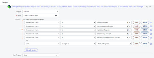

Here is the flow:
Applies only to specific catalog items, when the status changes to work in progress:

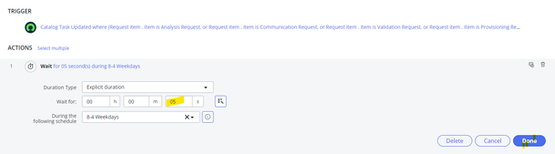

For testing I set 5 sec:

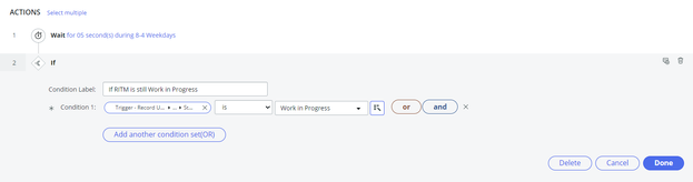

then after 5 sec it will check if the status is still closed complete and if true, it will change it to closed complete:

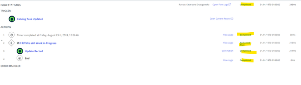

Testing a sc_task record:

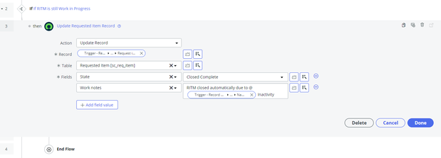

then the record is updated correctly:
but when I dont do those test for the sc_task record the RITM status does not change... why?
