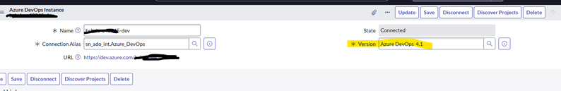

The version of Azure DevOps that we were told to enter is very old, 4.1 - this is the indication that they aren't updating this integration.  This is even older than what is listed in their documentation.  However, it is what we received from their development team after opening a Support ticket when something wasn't working.

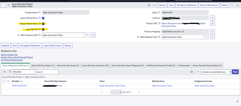

If you want to enable bi-directional integration, you need to have these enabled on your project record:

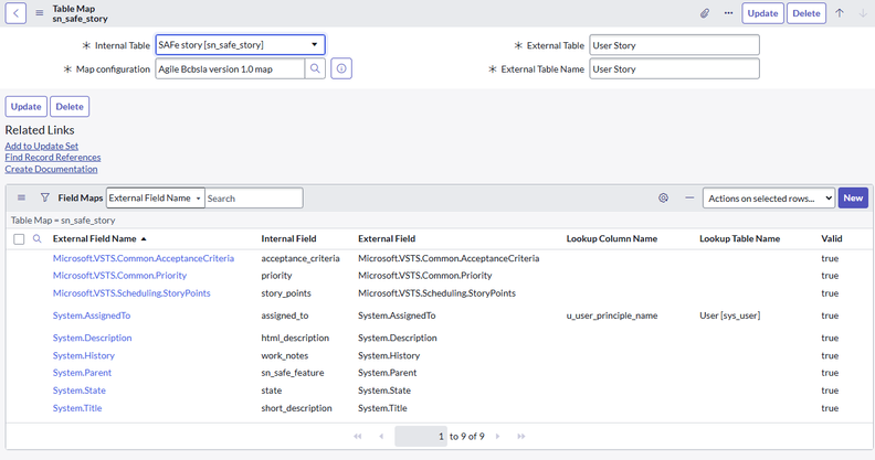

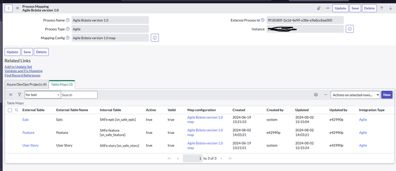

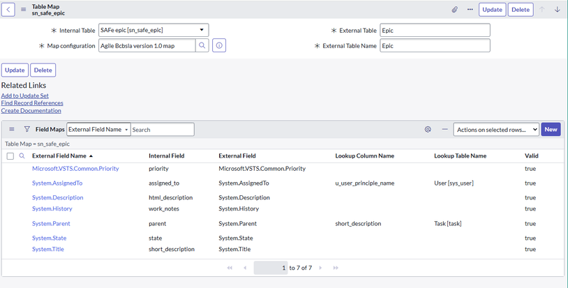

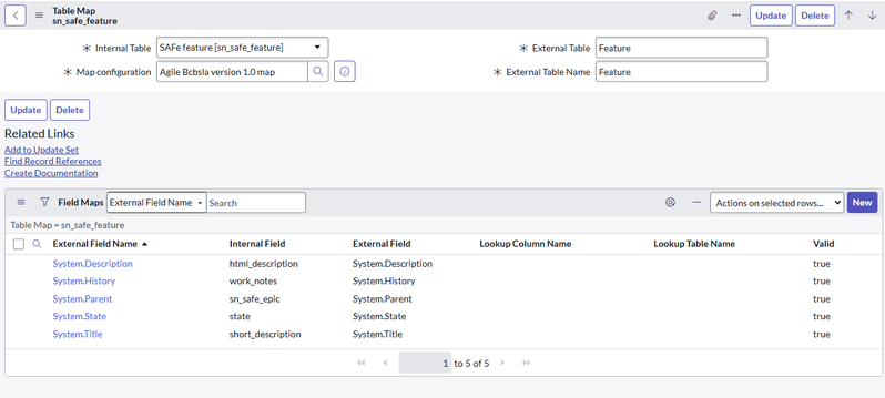

Also, the mappings are very tricky.  We had the most problems with that.  I will add screen shots for your assistance.

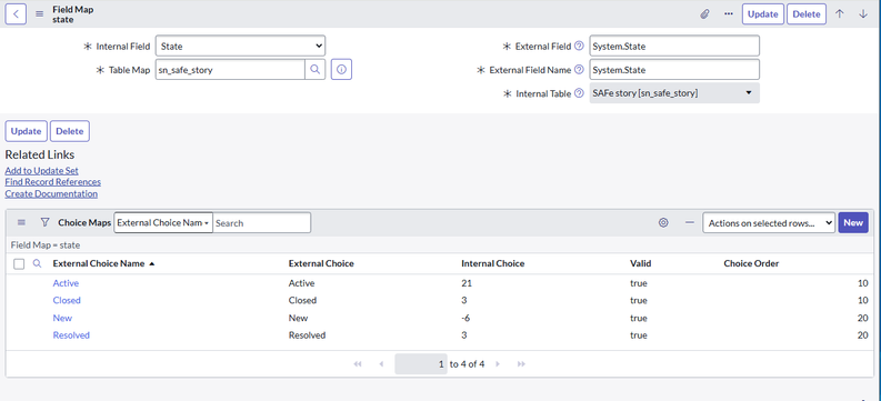

On fields with choices/states, you have to define the mapping for those as well. They will depend on how your company wants to map those.  Here is an example:

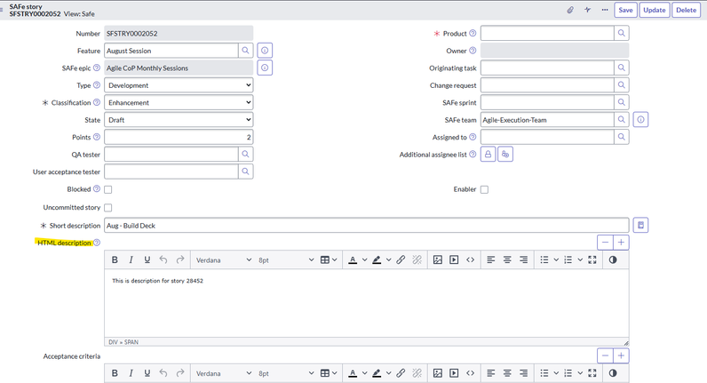

We also found that we had to switch from using "description" to "HTML description"  field on several of the forms because the data coming from Azure DevOps was in html format and wouldn't show up in the description field until we switched to the HTML Description field.
