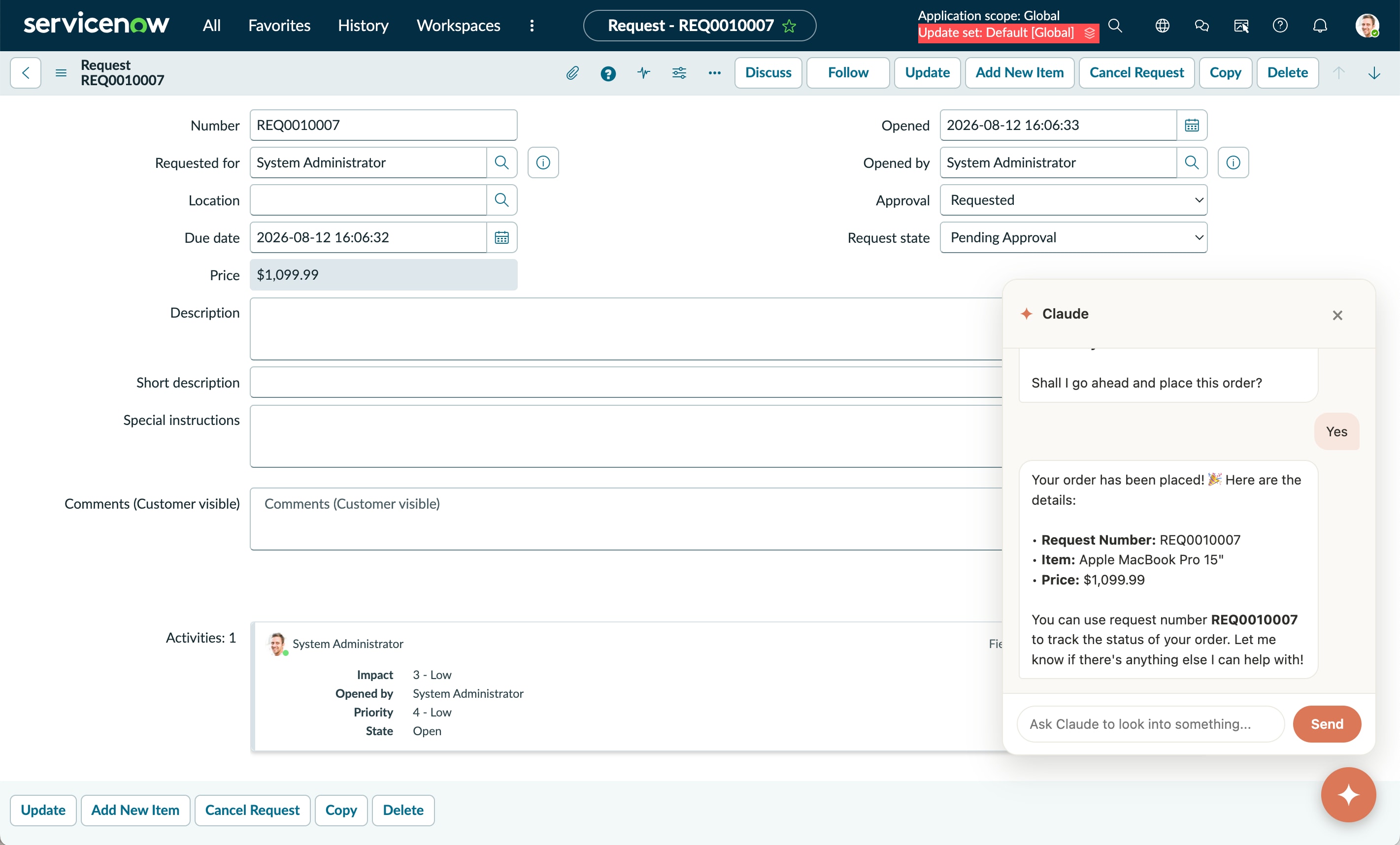

Built the same ServiceNow agent three ways, native, external MCP, interactive. Here's what changed.
AlexMcDonald
I wanted to know how much of an agent survives when you change where it runs, so I built the same one three times against the same platform.
External over MCP, a Python orchestrator calling Claude through the Anthropic API and reaching ServiceNow through an MCP connector. Interactive through Claude Desktop, same connector, no deployment. Native inside the platform, a Script Include and Scripted REST API, no MCP hop at all.
The native version runs as the requesting user through GlideImpersonate, so permissions come from the platform's own ACLs rather than something I had to build. It places real Service Catalog orders through the Cart API, and every reasoning step gets written to a trace table so a run can be replayed later.
One tool design bug worth sharing separately: a query string with strict syntax let the model silently malform a sort clause, no error, just quietly wrong order. Fixed by moving sort out of the string into typed parameters the model can't get wrong syntactically.
Full writeup: https://www.linkedin.com/pulse/most-enterprise-ai-agents-chatbots-i-built-real-one-three-mcdonald-rl...
Repo, open source: https://github.com/BrianMcD47/servicenow-claude-mcp-bridge
Curious how others here are drawing the line between building natively versus reaching for MCP.
