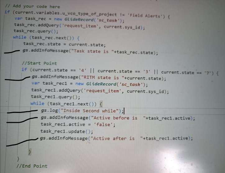

I have modified an already existing BR and the BR is giving info Messages what I have written but not changing the Active field value to false. Please help me.

@Lucky1 try the following and see if it works
task_rec1.active=false; //false without quotes
task_rec1.update();

Hi @Lucky1
After task_rec1.active = false add below line.
May i know why you are directly updating the active field instead of updating the state field as closed complete/incomplete?

Yes Sandeep,
It's working now.
I will come back.
