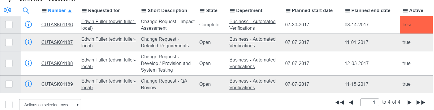

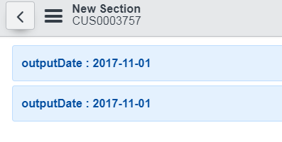

I am updating "CUTASK01189" in the below screen shot from 11-26-2017 to 11-15-2017 which should update the parent due date to 12-03-2017 seeing that is the furthest date out in the list below
When I updated the record to 11-15-1017, it set the parent due date to 11-01-2017 instead of 12-03-2017

antin_s
Please change the Business Rule to run 'after' ( not before) and use the updated script below. It works for me perfectly.
