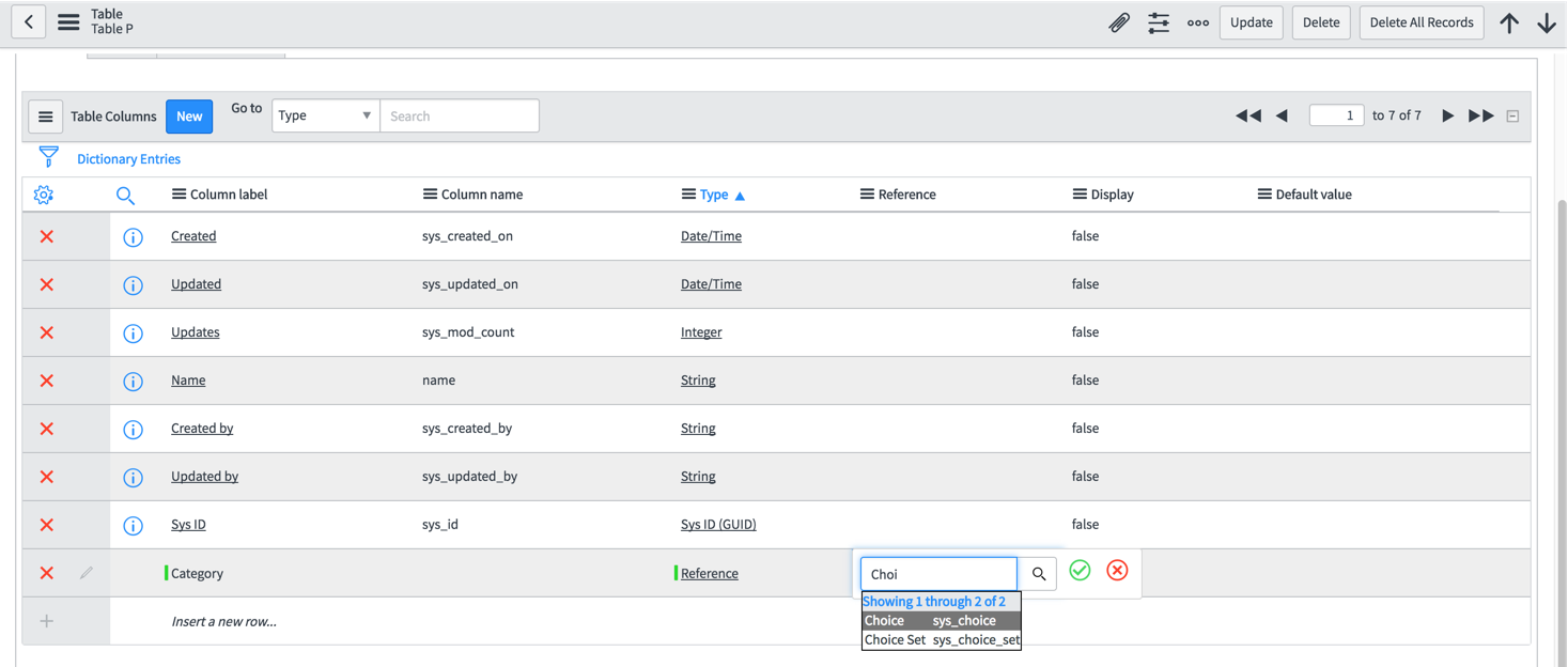

reg_1979
Hi Alex,
This table should be allowed to be referenced. My instance is Helsinki.
Please see the screenshot below.
Do you have any customizations on your instance that could be preventing this? Are you logged in as an administrator?
arobertson
Strange,
I was trying to add the reference field via form layout and the table was was not there? but i was able to add it fine going straight into the table and adding the field...
