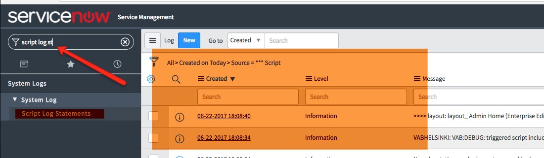

Hi Vab,
Where can i see the output of gs.log()?
Thank you
thiraj
vab_13
yes, this should work
It will print here:
