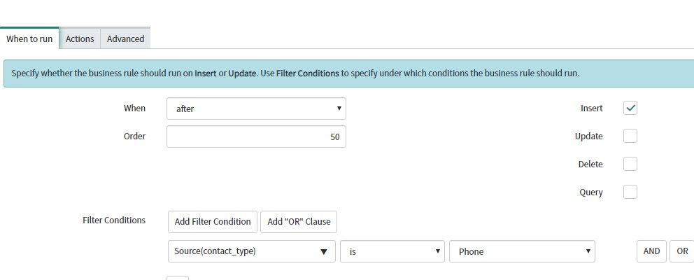

05-07-2020 08:37 AM
Hi
This is my final script which is working to set the assigned to and source on the HR Case.
I am using the current.update() in the after business rule with out which I am able to do it .
Please suggest if this will cause issues

05-07-2020 08:55 AM
For being safer side use the below script just before the current.update()
current.setWorkflow(false);
Note:- Using setWorkflow(false) will restrict the auditing of any insert or update of record.
