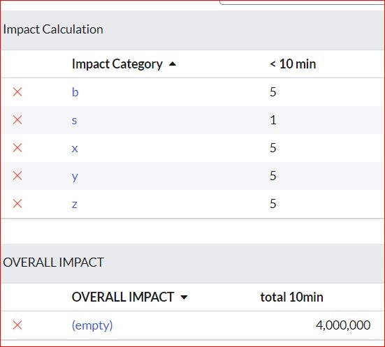

Hello Everyone,
I have created 2 Tables and the first table impact calculation and second one is overall impact. I would like to calculate total of <10 min field from the first table and then populate in the second table overall impact table in total 10 min field.
In the first table <10 min field is choice and in the second table total 10 min field is integer.

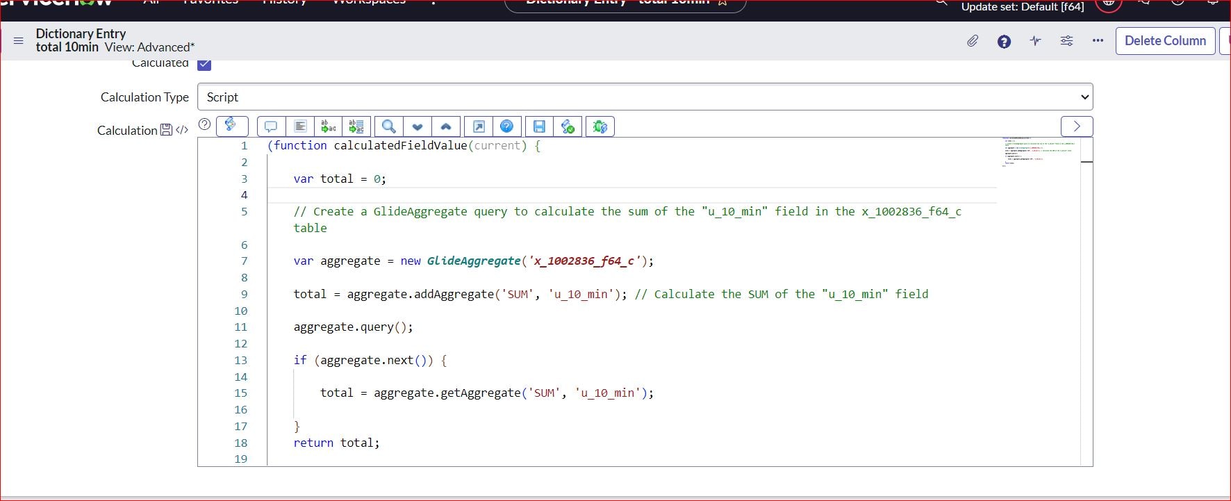

this is my script
(function calculatedFieldValue(current) {
    var total = 0;
    // Create a GlideAggregate query to calculate the sum of the "u_10_min" field in the x_1002836_f64_c table
    var aggregate = new GlideAggregate('x_1002836_f64_c');
    total = aggregate.addAggregate('SUM', 'u_10_min'); // Calculate the SUM of the "u_10_min" field
    aggregate.query();
    if (aggregate.next()) {
        total = aggregate.getAggregate('SUM', 'u_10_min');
    return total;
with this script calculate only the same  biggest  number not all number in  the list view. As you see in you screenshot below. (calculate only "5")
I would like to calculate total of <10 min field and then populate in the overall impact table.

I came across the below post. It appears that if you aren't using "addGroup" with  SUM aggregate, it still tries to group by a value in the background. (It groups and sums the same values together, so all your 1s, 2s, 3s etc if you output these throug a while loop)
https://www.servicenow.com/community/in-other-news/glideaggregate-sum-not-summing-correction-is-it-s...
    var total = 0;
aggregate.setGroup(false);
    aggregate.query();
    return total;
So to fix it you need to add the line "aggregate.setGroup(false);" into your script
