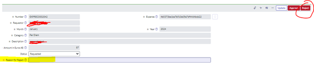

Im working on a functionality that will allow to change the status of a record when a button is clicked.
I have an UI Action (client) so that when the button is clicked 'reason for reject' shows up and is set to mandatory:
I want the approver to be obliged to provide 'reject reason' to be able to change the status to 'rejected'.

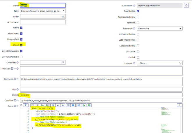

Here is my UI action:
is it possible to call Script Include that will handle the logic of the record update? (changing the field value to 'rejected' and adding the 'reject reason').

You can use a ui action that can run client and  server code both, like below
function runClientCode(){
if( == false){
return false; //Abort submission
//Call the UI Action and skip the 'onclick' function
gsftSubmit(null, g_form.getFormElement(), ''); //MUST call the 'Action name' set in this UI Action
}//Code that runs without 'onclick'
//Ensure call to server-side function with no browser errors
if(typeof window == 'undefined')
runBusRuleCode();
//Server-side function
function runBusRuleCode(){
current. = ;
current.update();
gs.addInfoMessage('You did it!');
-Anurag
Please correct me if i am wrong: I have to create another server side UI action that will handle the record update logic and then in the client UI action I have to add the name of it:
No this is the same ui action that you have, the client side one, you can just modify it to run server side script also
function onClick(){
if( == false){
//Do the client side things here, making field mandatory and all that
gsftSubmit(null, g_form.getFormElement(), '<add the action name of the this client siode ui ction here>');
runServerCode();
function runServerCode(){
//Do the server side things here
-Anurag

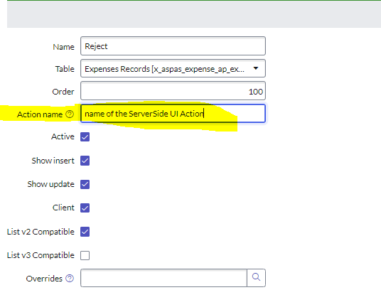

So what the field "Action Name" is for?
