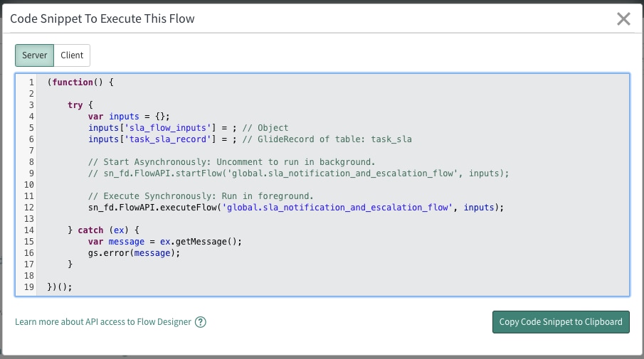

From any published Flow, Subflow or Action, you can generate a code snippet.
Snippet:
This snippet will be pre-configured with whatever inputs the flow/subflow has defined. You can then call this in an onBefore or onAfter transform script.
In the transform map, create a new Transform Script.
And then use the code snippet as a starting point to call the flow and pass in the import set row.
Note: For easier debugging, remove "Quick" from the method name to see the flow execution history in Flow Designer. Only do this for a limited number of records.

2. As of Madrid, all Flows, Subflows and Actions can be called via API. You could build a Subflow that takes an Import Set row as an input, and you can then do whatever processeing you need within the flow. It can either A) returns the transformed data as an output, and you can then use that in the transform map or B) directly insert/update records into other tables.
You can then call this subflow from an onBefore or onAfter script in the transform map.
If you do go this route, use the executeSubflowQuick() method to ensure that no reporting/context data is recorded; otherwise, you may overwhelm the platform with flow execution reports.
Snippet:
