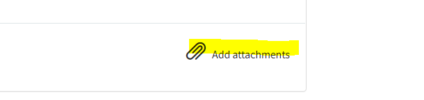

I am working on a Record producer and i need to make it mandatory when i have a question as Mandatory Can we do that?
I tried using Variable type attachment but unfortunately it is not working as per use case and ended up having multiple issues like we cannot add mulitple attachments.
