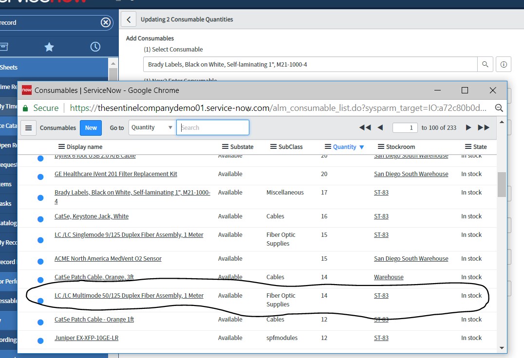

I've created a Client script to autopopulate a form based on the original entry.  All in, I'd like to autopopulate 4 fields for alm_consumables.
I can get two to work, since I've built a reference to another table from which they are retrieved from.  The other two are pulled from choice fields.  I can autopopulate the field but the data is retrieving the value instead of the Label.
Is there a way to autopopulate the Value?
Client Script
Current result:  subclass and substate are not populating properly to populate the alm_consumablesfind_real_file.png

I tried that before I posted and it still retrieves the value.  Below is the what I created.  I think I could have the 'Values' match the Label to get this to work but I don't think that's recommended...
This is the choice setup
Here's the script
Item ordered
Result
