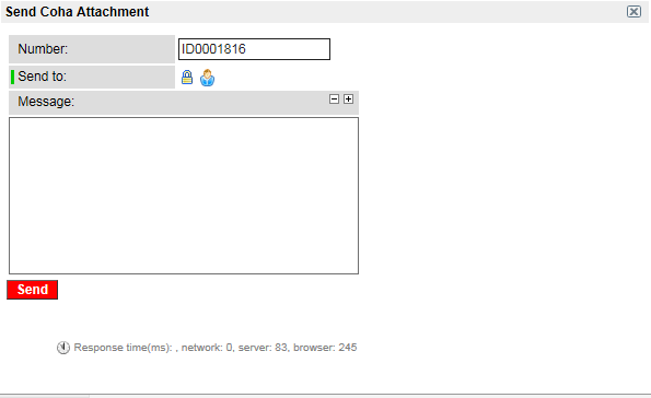

I am trying to achief a popup dialog window. I am almost were I want to be with my development. Except on the size of my popup.
Initially the size and the way my popup is being displayed is fine.
It is when I "unlock" my reference field that it isn't any more.
Popup before I click the lock:
Popup after I click the lock:
As you can notice I don't have a nice screen anymore.
I have no idea how to fix this so that I have good with and height.
Or maybe an auto resize when I click the lock.
User Interface (UI)
06-17-2015 06:39 AM
Just in case you all wondered how this ended...
I have found a solution without a ui page.
I continued working on the UI Action but instead of using using "GlideDialogWindow" , I have used "GlidePaneForm".
I use the method to call a view and displays it in a larger window then a popup.
The result is a good lay-out
Thank you for you help Daryll and Ashish

I wanted to add the way I created this popup.
It is an UI action script.
You might notice some commented lines of code where I attempt to reach my goal.
So far no success...

I've done this before and it works fine.
Here is my script to resize the dialog window...
var dialog = new GlideDialogWindow('terms_acceptance_dialog');
dialog.setTitle("Please be aware..."); //Set the dialog title
dialog.setSize(900,800); //Set the dialog size
dialog.removeCloseDecoration(); //Remove the dialog close icon
dialog.render(); //Open the dialog

The last screen shot you posted looks like it has got wider. Maybe you just need to adjust your width to be a bit wider
