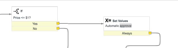

I'm trying to alter the auto-accept conditions from the defaults, $1,000, and am running into issues.   In the Worflow Editor I've made several alterations each time when I go and create a test request I get:
Request automatically approved for total price <= $1000
Currently I've set the condition to $10k, but still get the message above when creating a test request:

michael.ritchie Found it, and thank you, the workflow has a Set Values: Automatic Approval.   The default value for this is:
comments=Request automatically approved for total price <= $1000^EQ:
which is where it's being set, and not the previous stage the 'If' statement.   All good, thank you much.

Yigal, Approval rules don't work with workflows so you will need to edit the workflow itself.   I see from your screenshot that you edited the name of the activity, but please confirm you changed the actual condition in the workflow:
If you did change this, please post a screenshot of this workflow activity from your workflow so I can try to help further.
