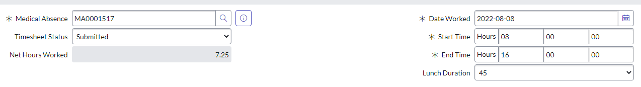

Upon submit, the record producer will create this record:

All that said, the code is working exactly as I'd hoped ... except when I choose a time over the noon hour (12:00 PM / 12:15 PM, etc.) Those times are being read as midnight, not noon.
My log statements show the data being set incorrectly:
Do I need to show these choices in a different format? How do I ensure that 'noon' hours are recognized properly?
