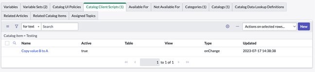

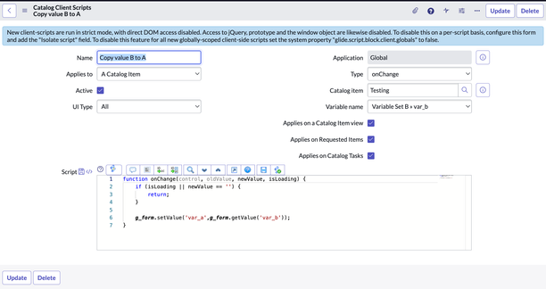

I create an example based on your question:
There are 2 variable set "Variale Set A" and "Variable Set B"
In the varible set A contain variable (var_a), for the variable set B (var_b).
The variable inside these variable set can be access to each other, if you create a catalog client script.
I've create on onChange Catalog Client Script to copy the value of B and set it to A (in the Variable name field you've to choose the Variable Set that need to be capture to another one).
Please try this approach, put some alert if you need to see the value of the field.

if you want to do some processing on C OR D when A or B changes then 2 ways
1) create onChange catalog client script which Applies to your Catalog Item and select the type as onChange and select the variable A or B
OR
2) create onChange catalog client script which Applies to your variable set and select the correct variable
Since you told you don't own the variable set then you better go with option 1 as the script will run only for your catalog item
