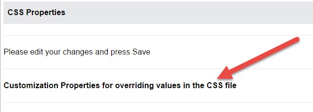

The system properites CSS does say this:
So anything changed there should override the heisenberg_all.css file.   <shrugs>
