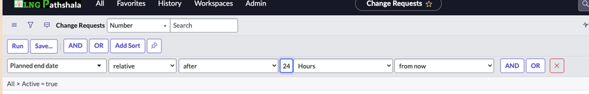

I am trying to create a ServiceNow Notification to Change Assignee
Requirement is - When the Planned End Date is more than 24Hrs and Change Request is still not closed then a notification to be sent to Change Assignee to close the change request as its overdue. Then Reminder notification to be sent after 48Hrs if still not closed. I would like to filter change requests based on state so that it does not generate trigger draft changes.
I tried using the below condition but its not working, Any idea what wrong with the below filter conditions? Thank you
Note: To test the notifications set at 5min

To simplify it, create the condition at the list view first and check if you are getting the changes or not.
I am getting 1hr, 2hr ago Planned end date changes as well, Do you know how to achieve based on my requirement? Thanks
Try from Now.
It wont work with From Now as well
