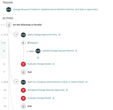

1st: I have a Change Flow that triggers when the Model is Normal and the State is Approvals (see Flow below)
2nd: I have a separate flow that triggers at the same time as the first if certain conditions are met (see Flow below).
3rd: I have state model transition set on my Normal Change Model. It is an automatic transition, but both the conditions must be met.
When the normal change is created, it creates the task and approvals successfully. So if all approvals are completed first and the Change Task are completed last, then I noticed that the Flow Engine Context that the system ran 1st flow again (see screenshot below)
I am unsure why this is. But if I complete all the Change Task first and then the approvals, then it works fine.
This is their process and I have to have both approvals and Change Task during this state and it must be completed before moving to the next state. I figure my issue is the 2nd flow and possibly having the evaluate change model. Or it could be my model, but what I don't understand is why the system triggers the 1st workflow again if completing the Change Task last.
