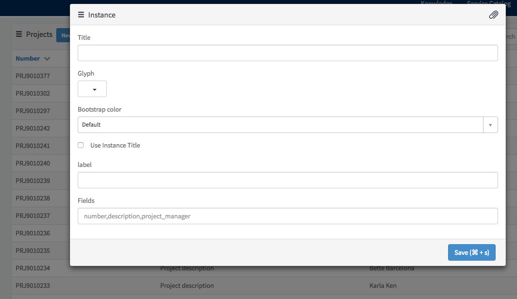

I think I figured out how to configure this for the Data Table from URL Definition easily!
1. Go to the page where you have the Data Table from URL Definition widget (e.g. https://xxx.service-now.com/sp/?spa=1&table=pm_project&id=data_from_url&filter=&p=1&o=number&d=desc
2. Ctrl and right click and select Widget Options Schema
3. Click on the + icon to add a new option, and save the record.
Label:   Fields
Type: string
Default Value: <comma separated list of fields>
4. Ctrl and right click to select Instance Options.   Here you should be able to see the configurable options for your widget instance.   Since we just added the Fields option, you can configure the fields you would like to display for this widget instance if you want to overwrite the default as set in the previous step.

Hi Rita,
Label:   Fields
Type: string
Hope this helps!
Jenny
