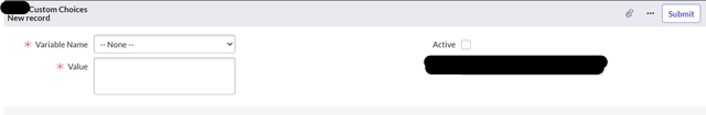

Hi!
Is there any way to make the "string" field dependent on a custom table aside from converting the "string" field to "reference" field?
We have a custom table wherein we can add values in a custom field and the fields that are in the "Variable Name" are all "reference " to this table.
And we have a "string" (dropdown choice) field here and we need to add this as one of the variable names where the user can add other values... Im thinking if we need to delete this field and create a new field that is reference to our custom table.
