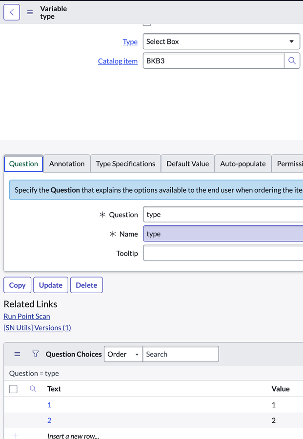

I have a catalog item, and within the catalog, there is a specific variable that needs a reference qualifier. When building the reference qualifier, I am passing the current object. Within the Script Include, I am unable to access the value selected from a specific variable. The variable is a select box type with 2 choices.

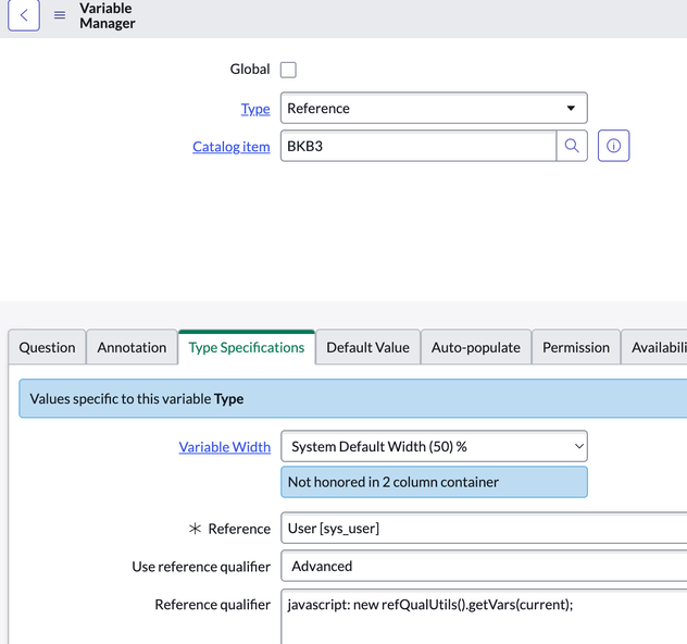

My reference qualifier is very simple:
javascript: new getAssetInfo().returnQuery(current);

That reference qualifier can't work with that Script Include as the name of the SI needs to be getAssetInfo with a function named returnQuery, following the reference qualifier format.  Beyond that, I tried this in my PDI and was surprised it worked as 'type' is not the best choice for a script variable name since it could be a system/reserved word.  Are you certain 'type' is the variable name - no extraneous spaces or mis-spellings?

can you please provide an example of what you did in your PDI? My select box value is empty within script include
var refQualUtils = Class.create();
refQualUtils.prototype = Object.extendsObject(AbstractAjaxProcessor, {
	getVars: function(current) {
		var type = current.variables.type;
		gs.addInfoMessage(type)
		return
    type: 'refQualUtils'
