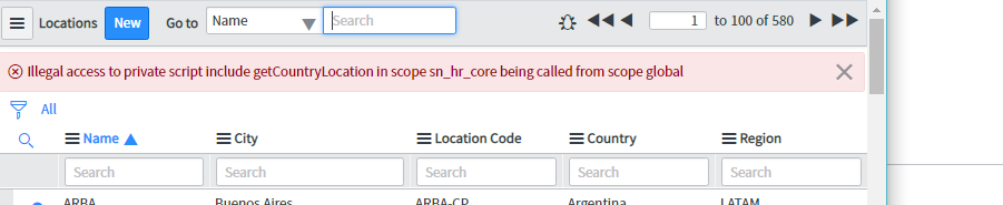

I have tried now it is getting some error but still am able to select all the locations of all the countries.

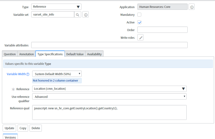

Weird. Now before changing anything could you get me a screenshot of your current scripts?
The reference qualifier as it is and the script include with all the options visible as well.

Hi Joni,
Please find the screnshots in the attachments.
