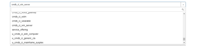

I want to display the cmdb_class_info in a drop down from the portal view for the user to select.  When I do that I just get class name, but I want to also show the display name to the user.
This is what I have displaying on the catalog item variable

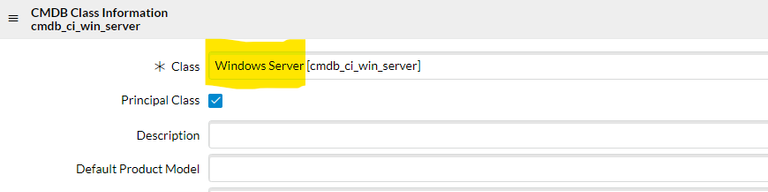

When I go to the referencing class (cmdb_class_info)
I am able to see the display  name
How can I get the display name that is more user friendly to show up on the dropdown for the catalog item?  The variable I currently have is a lookup select box
