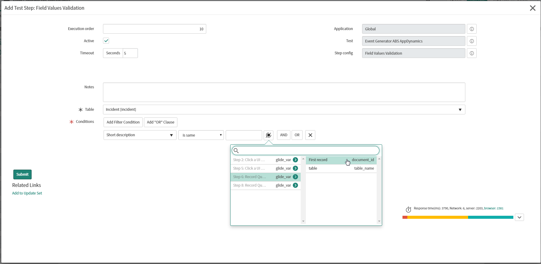

How do we compare the Incident Short Description, for example from above, to the related Alert Description?
When the Test Step, Field State Validation, is used for Step 10, the Input Value Icon only lets me select the actual record from before and the tree picker hierarchy never appears. You are only able to select the record and cannot compare fields on one record to another.find_real_file.png
Does anyone know how to do this comparison?

I used to have a similar question here and found an answer - maybe it can help you. In my case the verification was for one field only.
To do that I used a Run Server Side Script with a piece of code that would have as Output the value I wanted (in my case, it was a sys_ID of a CI. But it can be any field you want, I already used with Name field as well).
Look at the accepted solution: https://community.servicenow.com/community?id=community_question&sys_id=5a10da8ddb97f780d58ea345ca9619ce
For your case I believe you would need to have one Run Server Side Script step per value you want to compare, since I assume it is not passible to have more than 1 output per test step.
