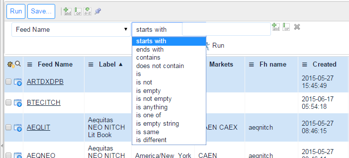

And here's one that miraculously works as expected:
Any clues as to what might be going on would be greatly appreciated!

Could you please provide a snapshot of the dictionary entry of 'Label' field?
Filter option differs based on the field type.
Here, 'Label' could be a special type of OOB field.

I just remembered an important detail! (I created this table months ago)
I created the table using the standard gui interface - I went to tables/new and created it. But then, I took all the field names (from another database) and imported them into sys_dictionay using a transform map. In this way, I got all the fields created rather quickly instead of having to enter them all by hand. (Got the idea here:How to automatically create a target table for a data import set?) I bet there's something about this method that created this string 'differently' - but what? The dictionary entry is indistinguishable from another entry that works properly!?!?
‎09-23-2015 10:50 AM
I've now discovered that naming the column 'Label' was a bitterly unfortunate choice. By renaming the column to 'Long Name', the behavior changes and the string now offers up the slightly stunted "Is", "Is Not", "Is Anything" operators. "Label" has special meaning in this context apparently. Still - I want the full gamut of operators.
I tested creating a string the normal (gui) way and the strings I create in this fashion behave properly.
I wish I knew what it was about the direct system-dictionary 'auto' creation that was lacking.
