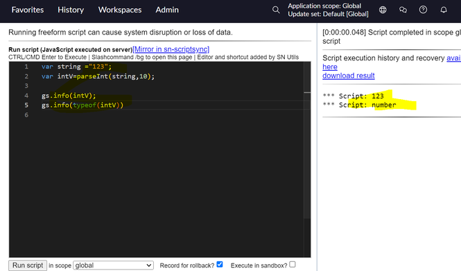

10-04-2023 10:28 PM - edited 10-04-2023 10:30 PM
Hi @_Samay
If you are using script then you can use :
var string ="123";
var intV=parseInt(string,10);
OR
If you want user to put only numbers in string field then use regular expression on that field (client script)
var fieldValue = g_form.getValue('your_field_name');
var regex = /^[0-9]+$/;
// Check regular expression matches
if (!regex.test(fieldValue)) {
alert('Please enter only numbers.');
g_form.setValue('your_field_name', ''); // Clear the field
