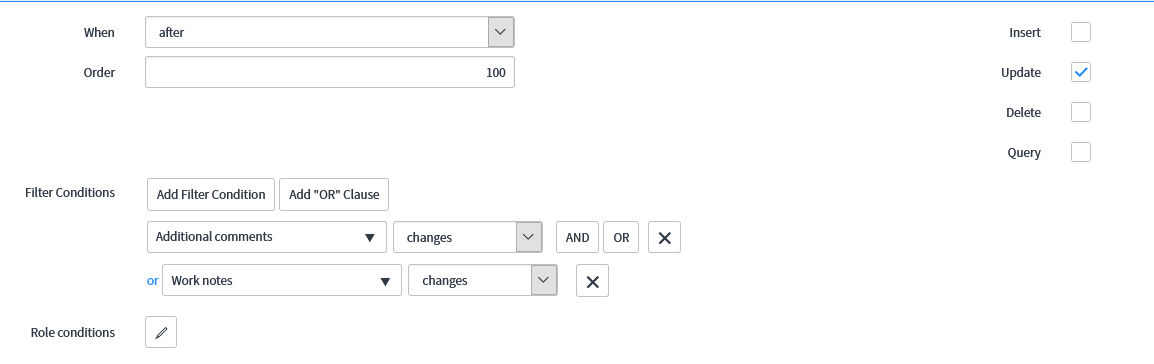

I have 2 business rules set up,
- Copy Comments REQ (sc_req_item) on sc_req_item table
- Copy Comments REQ (sc_task) on sc_task table
Both like the below -
Any update on the REQ record, does not update the RITM or SCTASK.
When the end user updates the RITM, it does update the RITM and SCTASK but x2, both with a comment and a worknote -
I am definitely doing something wrong/missing something but cannot figure out what.
