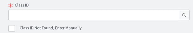

We are experiencing some really odd behavior where the value of a checkbox (from a Variable Set) from a Catalog Item that is being filled out in the Service Portal is not being reflected properly on the RITM that is submitted, even though the underlying table show the correct value!  I think this is best explained with an example.
So, we have a checkbox that toggles between two different fields (they have the same label, but different names; class_id and class_id2).  If the checkbox is not selected, the class_id field is displayed and made mandatory (and this is a reference field).  If the checkbox is selected, the class_id2 field is displayed and made mandatory (and this is a free-from field).
So, I am checking the box and entering in a free-form value, like this:
After submitting it, if I go into ServiceNow, and look up the value of what was submitted in the "Options" table, it shows that the check box is selected:
Now, if I bring up the RITM for this submission, and look in the Variable section, it incorrectly shows the check box as being unchecked, and therefore shows class_id (the reference field), like this:
If I manually check the check box on this form, I see my correct value (the free-form field):
The question is, why is it not showing the correct value for the checkbox when I bring up the RITM?  Has anyone ever seen anything like this?
