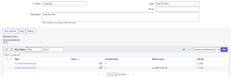

We currently have a database view already created between the Case table and Jira Issues table. I just want to add the Case Task table to that view as well. But I can't figure out how to configure the 'Where clause'. Here's what the database view looks like between the Case and Jira Issues tables.

In the table records, you also need to add fields that you want to use in where clause and fields you want to display in the database views.
The task table is a one to many relation. So your task table should be top in order. And in the where clause of case table you need to add t_parent = c_sys_id, assuming t is the prefix of task table and parent field holds the case

So it would be:
1. Case Tasks
2. Case
3. Jira Issues
What would be the Where clause for the Jira Issues table?
