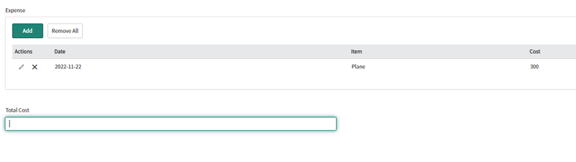

11-29-2022 07:21 AM
Thank you for this Brad,
do you know of a onChange script that we can used to sum up the total within the request and not wait on after its submitted?

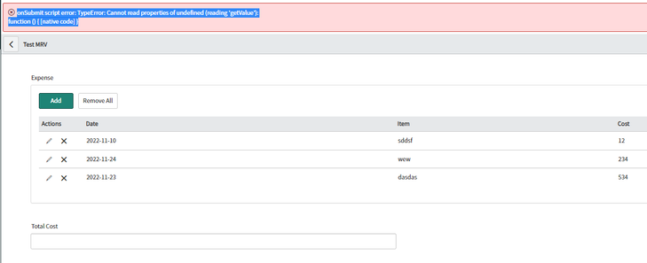

11-29-2022 07:32 AM
i am getting this from the script

11-29-2022 07:51 AM - edited 11-29-2022 10:07 AM
It sounds like you created the script with the Applies to field = 'A Catalog Item' instead of = 'A Variable Set'. MRVS onSubmit triggers when the Add button is clicked within the MRVS dialog window after populating the MRVS variables, so by the time you see the Total Cost variable back on the Catalog Item form, it will be updated - and all of this happens before the Catalog Item is submitted.
