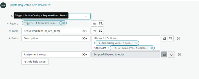

‎10-03-2022 01:24 PM
here is the update statement
‎10-03-2022 01:30 PM
in your record, select trigger only till Requested item, else i dont see any issues, apart from user you are checking may not have the location set.
