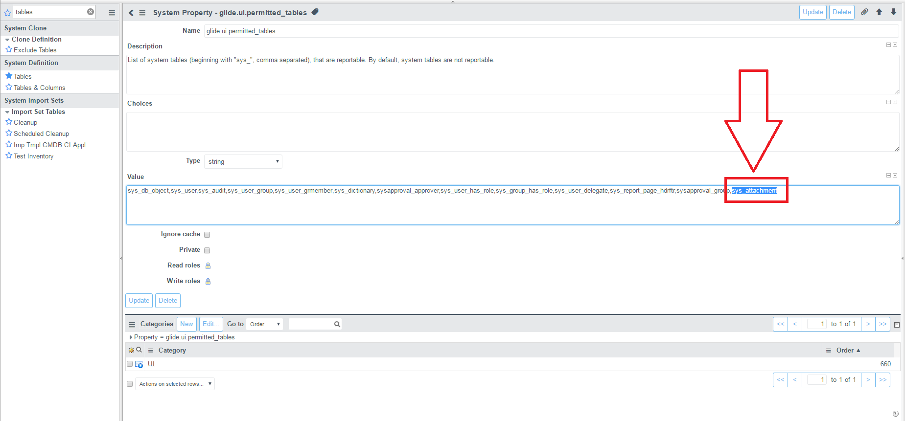

Just to let everyone in the community know,
Here is what I did in detail based on top of what Top Tanti.
1) I had to go into system properties.   Some may notice that this list not readily available so I had created link in the system properties tab (which may not be best practice).
2) or you can simply make your way here instead which i found to be a pain:
3) i was then able to make my way to "glide.ui.permitted_tables" and add "sys_attachment"
4) I was then able to go into the reports category and search based on attachments.
Thanks again to Top and the rest of the community for your prompt and helpful advise!
