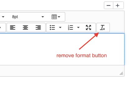

Adding the "removeformat" button to the html editor toolbar might make it less tedious.
When you add an unordered list (<ul>) right away click the remove format button and it will remove the "list-style-position: inside" style.
To add this button navigate to "system properties > ui properties".
Look for the "(TinyMCE v.4.0.26)" section near the bottom of the page. There are two but one is already populated. Add to the end of that one the following (separating with a comma): "removeformat"
Remember when clicking on one of the "list" functions or when the cursor is on one of the lists then click the remove format and it will remove the styling.
It's still tedious but a little less tedious.
