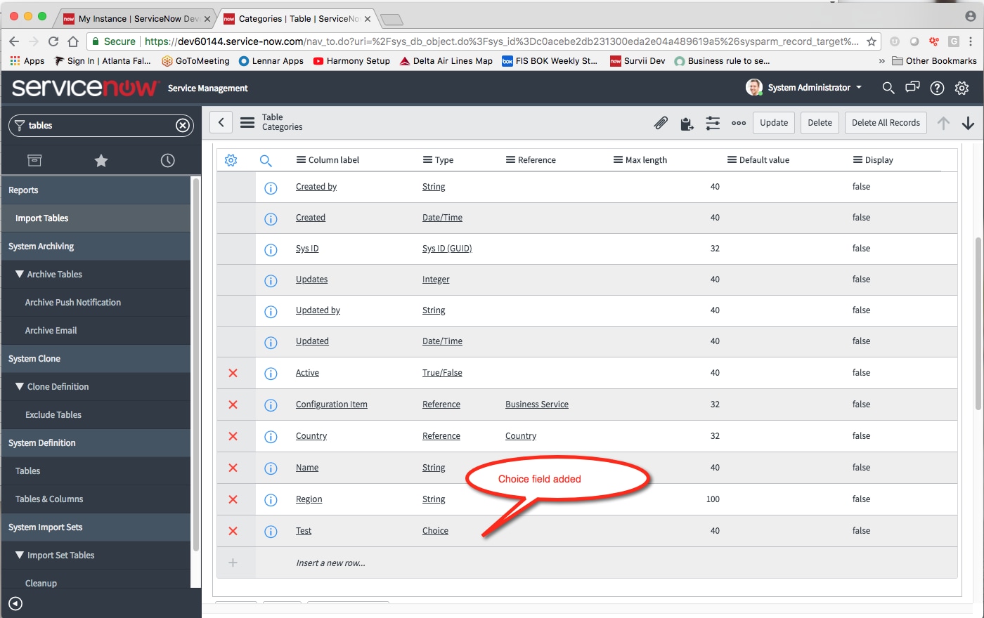

07-30-2018 05:34 AM
Still no luck! See screen shots below. Also, I am looking at other tables that show in the list of choice tables and they many of them don't have any choice fields in the table configuration. An example would be the Announcements Table. It has no choice fields, but is showing in the list of choice tables:
