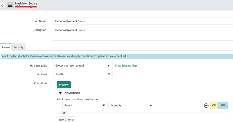

1) Create breakdown source on sys_user_group table and put condition as parent is empty that means it will fetch all the parent groups or you can add your query as per requirement to identify group as parent. Breakdown source will collect all the sys_id's of parent group.

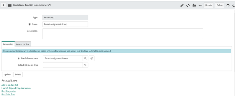

2) Create automated breakdown and link it to above breakdown source.

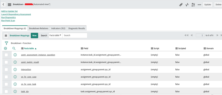

3) Create breakdown mapping to map it to target table.

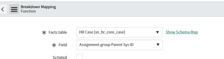

Here you need to map parent group's sys id of Assignment group field of target table.
4) Add this breakdown in your indicator. Run the scheduled job and check if breakdown is giving proper count based on target record stats.

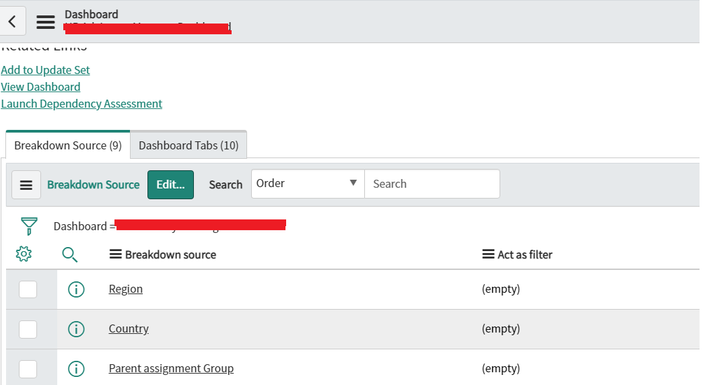

4) Add this breakdown source in Dashboard by going into "Dashboard properties" as below
6) Post this, it will appear as filter on the top of your dashboard.

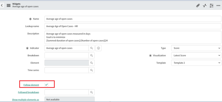

@WazzaJC You must have created widget and included indicator into it. You need to select the "Follow element" checkbox on the same widget so that widget will follow the element selected in the dashboard breakdown.
