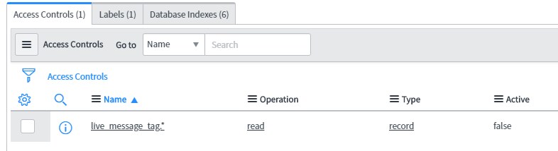

I have checked the ACL on the live_message_tag table, and tried adding a role that all our users have (ITIL) to the ACL, but still it didn't allow them to view the results. I then toggled "Active" to false on the ACL completely, and users STILL cannot view the results, so I'm led to believe this ACL is not what grants access to view the results of this report on the live_message_tag table.

The ACL you already have is not for the table. It provides access to all the fields on the table. Since you dont have one for the table the default rules will apply. So please create one with access to table.
It should be Live Message tag> --None--

Can you explain what I should do with this ACL? I see it has a script: gs.getProperty('glide.sm.default_mode') == 'allow'
There are no roles listed. The description also shows: "Allow snc_internal users access to tables if default mode is allow."

Ok so default mode is to "allow" access to table UNLESS there's an ACL on the table designating otherwise.
If I have deactivated the ACL on the table (shown in screenshot above) shouldn't all users be allowed to view the table results now?
