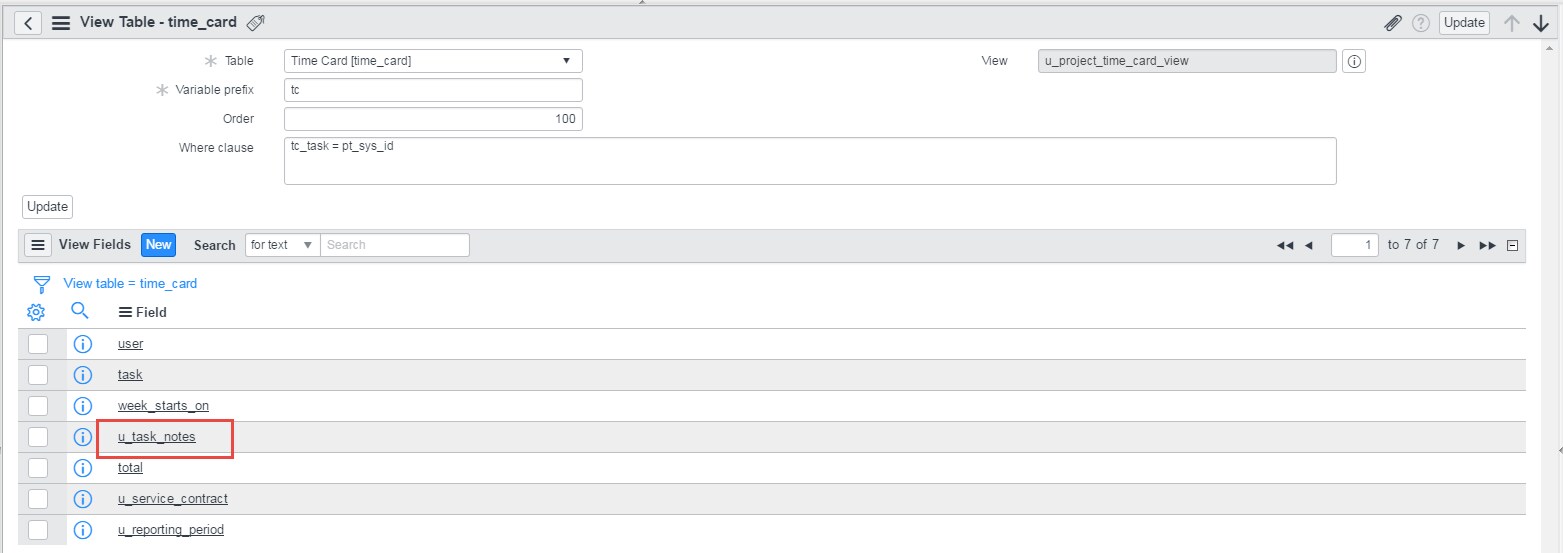

The requirement is to add the Task Notes (u_task_notes) field from the Time Card table to a view that is used for reporting time associated to project tasks.
I added the Task Notes field to the Time Card table in my view, but it displayed blank in the list... makes sense, because it's a journal field.   So I added the sys_journal_field table to the view with the where clause as shown, and added the value, element and element_id fields to its view fields.
But when I 'Try it' the Task Notes field is blank.   I've tried several other changes, nothing is working.
