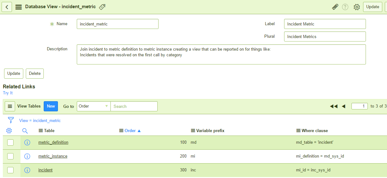

It is possible to create a database view joining n number of tables. Below is an example of the same:
This view joins the data from three different tables, i.e., incident, metric_instance and metric_definition.
You need to define a variable under Variable prefix column for each of the tables used and then use this variable to relate to a field from another table under the Where clause column with the appropriate condition.
Let me know in case you need further help with building the view..

Hi Supriya,
Thanks for the quick reply.
Our requirement is to get the result set from 3 tables into 1 with Union or equitant. Number of columns should remain same regardless of number of Unions.
Join gets columns from different tables. More number of joins mean, more number of columns. This approach is not suitable for us.
Any ideas.

You can try reporting on Task table with Group by as Task Type.
