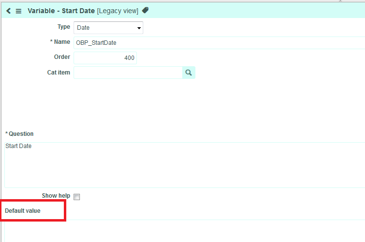

I have a date field where I want to ensure that the date selected from the date variable is not greater than the current days date. I have the following code for another date field that has to be 5 days out. Not very good with the date thing yet, so 1) should i have something like a (-1) in my dateMS portion of the script. And 2) will it render an error if the customer tries to select a date in the past or should I include some code that has an alert type of box stating something like "Please select a future date"......
var today = new Date();
var dateMS = today.getTime();
dateMS = dateMS + (5*24*60*60*1000);
var newDT = new Date();
newDT.setTime(dateMS);
g_form.setValue('ftr_needed_by',formatDate(newDT,g_user_date_format));
Thank you,
Karen
