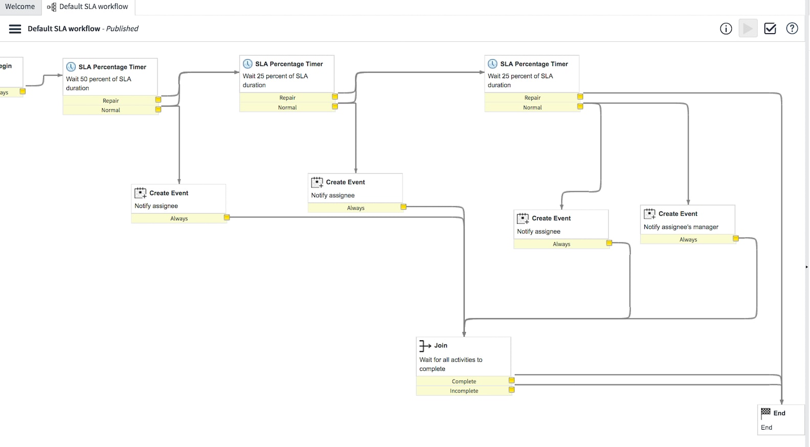

I've been creating Incidents that are using the Default SLA Workflow.   Looking at that workflow, I expected to get email notifications at 50%, 75%, and 100% with respect to the breach time.
I'm getting the emails at both the 50% and 75% intervals, but I don't get an email when the 100% mark is reached.

So, I noticed that your workflow isn't quite what comes out of the box. Last thing I can think of to try before sending to HI support. Update the workflow so it looks like out of the box.
The notify assignee:
The notify assignee manager:
