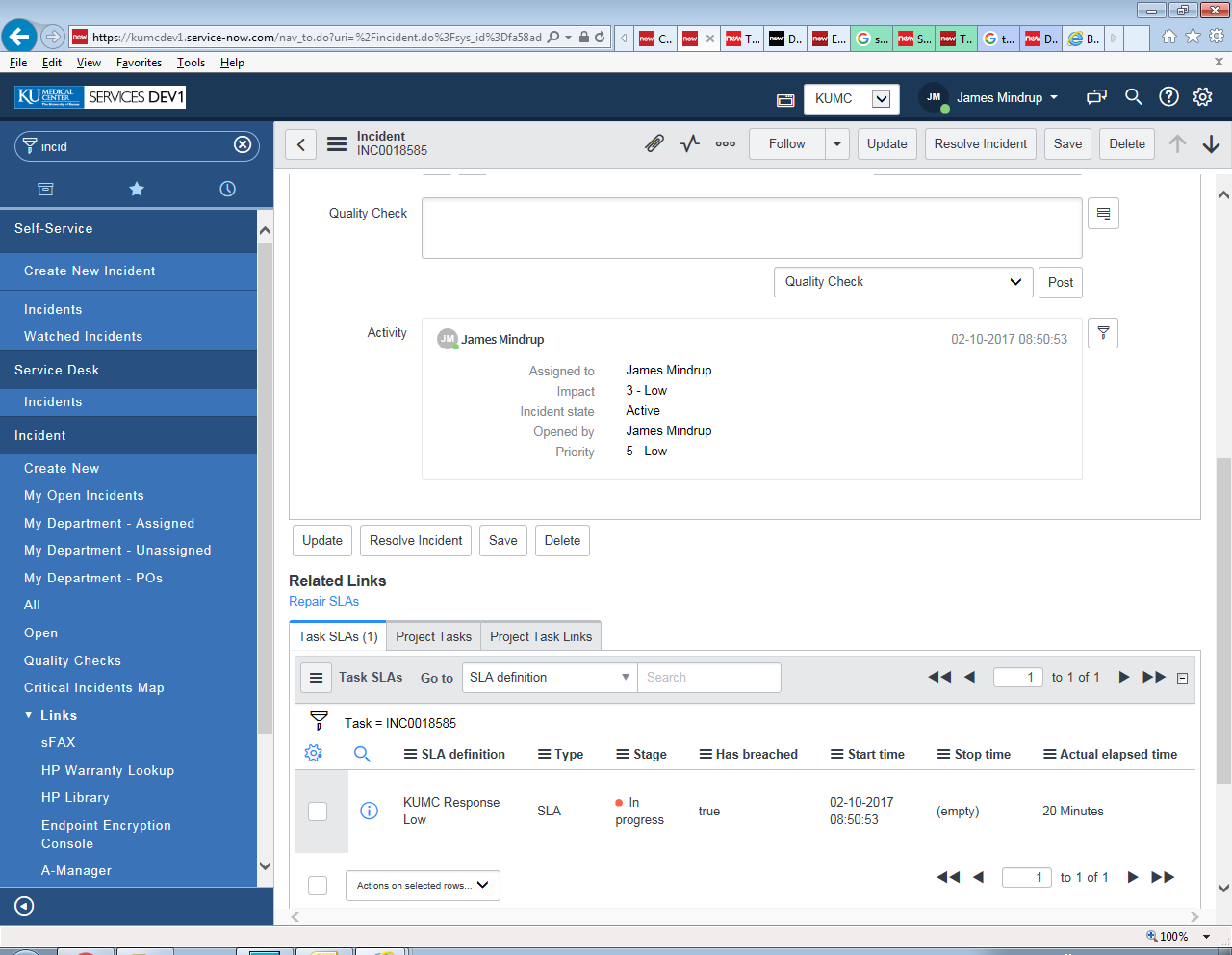

How do I get to the Task SLA form in order to then see the Workflow?   Need help with the navigation please.
I can see the SLA associated with the Incident (below), but not sure how to access the details of those specific SLA's.
