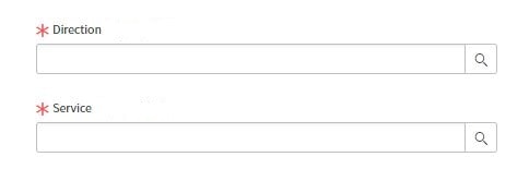

We have created 2 tables u_departement and u_service.
In the u_service table, we have a reference field (u_parent) to the u_departement table.
On a catalog item we have two fields Direction and Service
We want to filter on the Service field in relation to the value of the Direction field
kmickael
eHi Thank you for your help
I solved the issue !
i add a reference qualifier in the second field "Service" like that:
it's work
thank you
